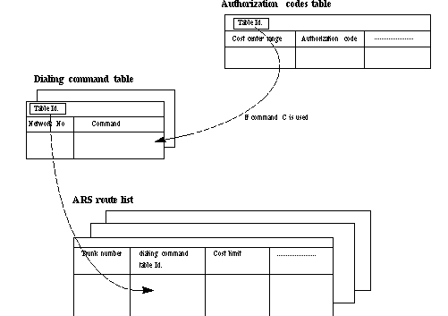

An authorization code is sent when command C (refer to DIALING COMMAND TABLE) followed with a number of the TABLE OF AUTHORIZATION CODE is used.
Each table number corresponds to a range of authorization number; indeed, in order to allow groups of users to have different authorization codes, one authorization code is associated to one range of cost center.
Below is the example of the interaction of the three ARS tables: the ARS route list may use the table of dialing command; if command C is used in the dialing command table, the latter uses the table of authorization codes.
