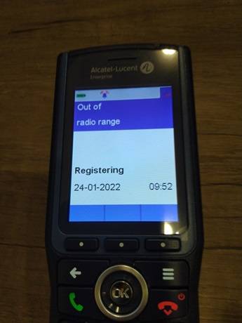

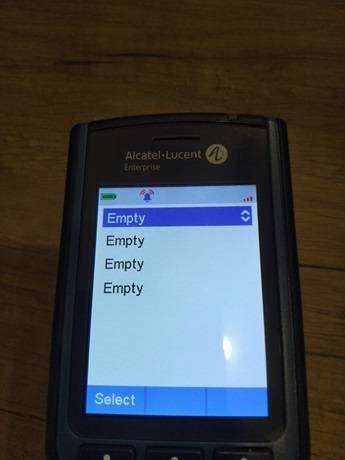

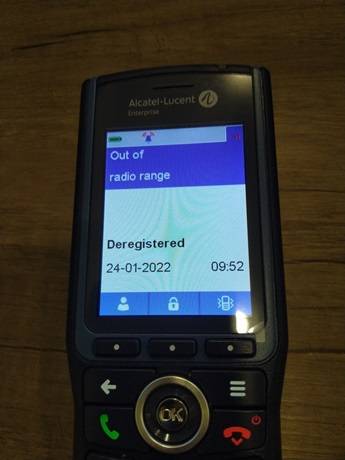

I am trying to make the dect handset 8244 register to a Gigaset dect base station but with no luck,
it always show 'Registering' then fall back to 'Deregistered'.
Another Gigaset dect handset works fine, it is able to register to this Gigaset dect base station.
Refer to registration steps of official manual here:
https://www.al-enterprise.com/-/media/a ... b-1-en.pdf
Chapter 7 Registering the telephone
For the mobile telephone to function, it must be registered on at least one Alcatel-Lucent Enterprise or GAP system (registration operation).
Refer to CAT-iq Certified products here: https://www.dect.org/cat-iq-certification.aspx
8244 is CAT-iq 2.0 compatible so it supposed to be able to register to a Gigaset dect base station,
is my understanding correct or my steps correct?
Any insights are appreciated. Thank you :)
My environment:
Alcatel-Lucent dect handset 8244:
SW Version: 6184b0003
HW version: V5R3
DECT band: EU
MODIC Setting: 8242 MODIC
Frequency: 1880-1900MHz
Gigaset dect base station: COMFORT A
Gigaset dect handset : COMFORT 520 HX
jones
Member
Posts: 2
Joined: 20 Jun 2025 05:08
Re: 8244 register to Gigaset base station
Post by jones »

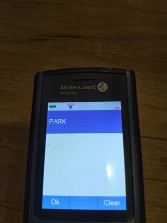

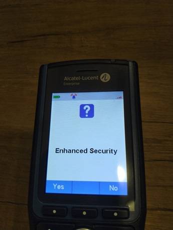

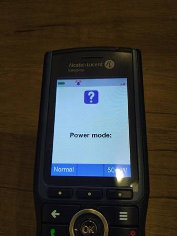

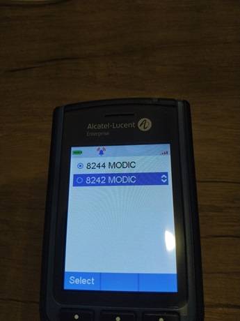

My step-by-step on registration as followings and finally got 'Deregisgterd' with no luck,
any feedback are appreciated, thank you :)

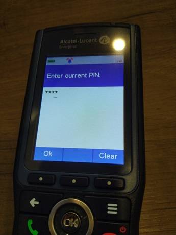

1. enter '0000' for PIN code
2. click 'Register'
3. click 1st 'Empty'
4. click Ok for 'Park'
5. click Ok for 'Access code'
6. click Normal for 'Power mode:'
7. click Yes for 'Enhanced Security'
8. Select '8242 MODIC'
9. screen show 'Regisering'
10. screen show 'Deregistered' finally

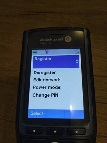

Finally it works! Two steps are changed:
1. 'Access code' enter four '0000', which might be default PIN code of base station;
in early days always simply click 'Ok' for 'Access code' might be wrong and invalid access to base station.
2. Select '8244 MODIC'.
main menu could see DECT network0
System: OXO IPDECT
You do not have the required permissions to view the files attached to this post.
